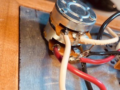

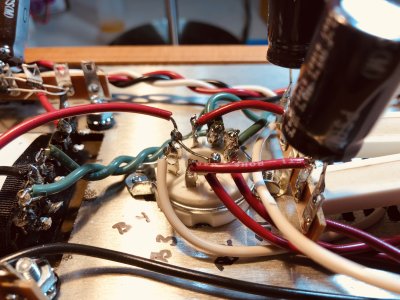

i have a noticeable crackle static in both ears and get hum when the volume is turned above about 1 o'clock. This is with no DAC connected to the Crack. Have not installed the speedball yet and all resistance checks etc tested out OK. I redid all the solder joints twice. After the first time, the hum went away but the crackle did not. After second time crackle remained and hum became worse than before. Tried deoxit on the tubes. I had burned the insulation a bit on one of the RCA female jacks so I replaced them. Found Doc's post about the black wire on the headphone jack so did this extra carefully.

Can you post some build photos?  Maybe there's something we can spot.

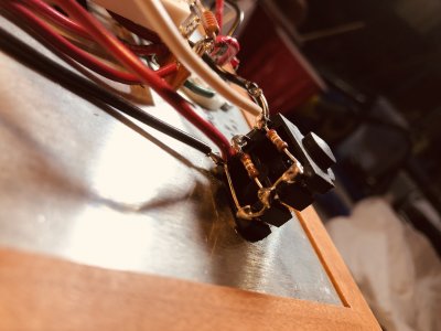

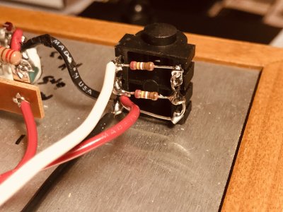

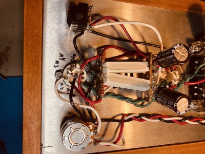

turning the DAC on makes the hum go away, but not the crackling sound. Here are just a few pics.

Reply #4 on: October 16, 2021, 04:12:49 PM

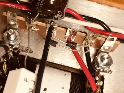

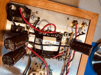

more pictures, just a few at a time

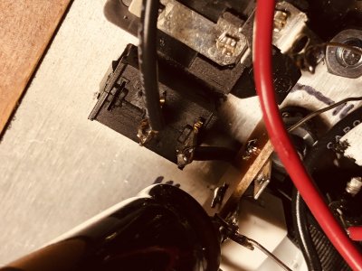

One of the black wires on your headphone jack is not captured by solder.
    • Posts: 20294
Reply #6 on: October 16, 2021, 05:14:10 PM
The diode lead poking through 19L needs to be trimmed back.

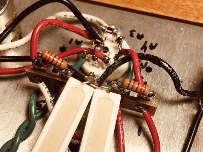

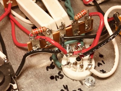

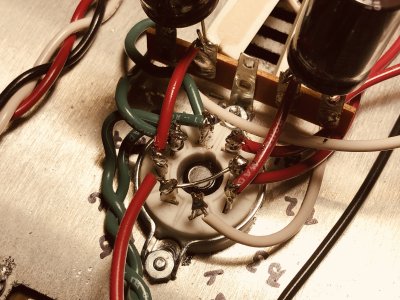

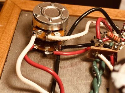

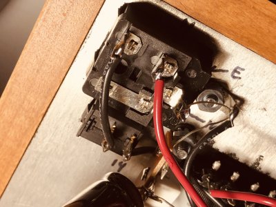

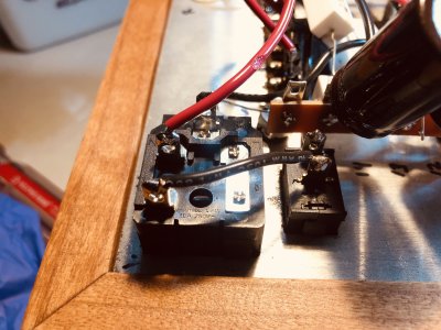

I tried desoldering the connection you mentioned and also clipped that wire. Took a while as I was tied up at work. It may have made some difference, but there is still a static in the right ear, with an occasional pfffft sound. does it help me narrow things down that it is in the right ear. I really appreciate your looking at the images and telling me where there are potential errors. I took some better close ups of different sections, posted below.

and some more...

The solder joint at 3L looks like it hasn't been well flowed out.
A strategy that can be helpful is to take a wooden chopstick and run the amp with some cheap headphones plugged in, then poke around the circuit to see if you can create the noise by poking something specific, then you can focus your efforts there.
