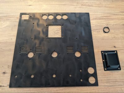

So the front side is kinda ruined because it was anodizied over the wavy pattern.
The question is, should I
  • Go via monumental pain and TWO companies, as this one can only remove anodizer in a solvent and reanodize, but not polish it. Minimal charges for polishing may be steep
  • Ask them to remove anodizer only and attempt DIY polishing.
  • Give up and powder coat it as a part on the right. They say it requires no polising.
  • Order another chassis from Bottlehead and polish and anodize it. I am in Republic of Ireland
« Last Edit: November 09, 2021, 03:31:01 AM by ipetruk »

I'd just get it powder coated. You'll have a range of colors available and it seems to be the path of least resistance. I've powder coated every one of my chassis plates but one and I've been really happy with the finish and the durability.

About ten years ago at a different job I was tasked with testing every anodizer in the Seattle area to determine if any could do a good, reliable, quality job.  None of them could; all of them ruined pretty much everything we sent them.
The anodizer you used should have run the panel through a grainer proir to anodizing.
I would definitely just get the panel powder coated.  You'll want to be careful to scrape off the anodizing and powder coating on the bottom side of the panel where much of the hardware mounts.
    • Posts: 9780
Reply #12 on: November 09, 2021, 05:39:48 AM
Before you decide on another go at it you might spend some time studying the type of finish texture you want and look at a lot of images of items with a similar finish. Powder coat comes in a large selection of finish textures as well, so the same advice holds even though the texture of the metal finish does not show like it does with anodizing.
I suggest either powder coat or hammered finish spray paint. Either one requires careful and thorough degreasing prep of the panel. With that care taken the results can be very repeatable. DIY polishing can be done but it is very messy and takes many hours to get really nice. It also requires very careful handling of the soft aluminum finish afterwards.

I don't know, just looking at the one picture, I think it's interesting. Have you tried setting the components in place and seeing how it looks? Maybe try a Matt clear coat or something
Just because it's not. What you were aiming for doesn't mean it might not grow on you. Give it a little time...John
