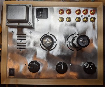

I forgot to add - the pictures in the manual are also great. They are so high quality and exquisitely focused that you can keep zooming in and in to see the finest detail. Well done to your photographer!
Here are my pics of the build.

Reply #3 on: October 27, 2021, 01:48:25 AM
Very nice build, inside and out. Enjoy!
