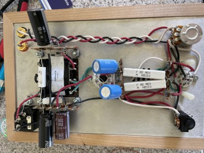

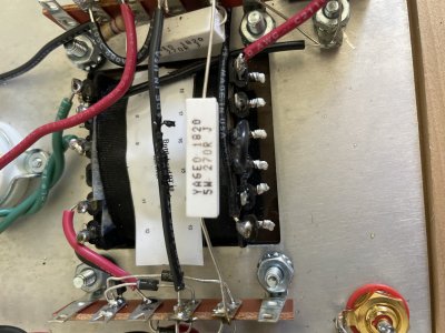

You're quite good at taking/posting pictures, so it probably wouldn't hurt to see some more images around the octal socket.
I suspect something is touching that shouldn't touch, and as the 6080 is warming up it's being forced to conduct excessive current.

Reply #4 on: October 27, 2021, 07:41:35 AM
Having 3 ohm 10 w resistors in that position will let a ton of current to flow. You need 3k ohm in that position.
    • Posts: 20308
Reply #5 on: October 27, 2021, 07:49:03 AM
Good catch!

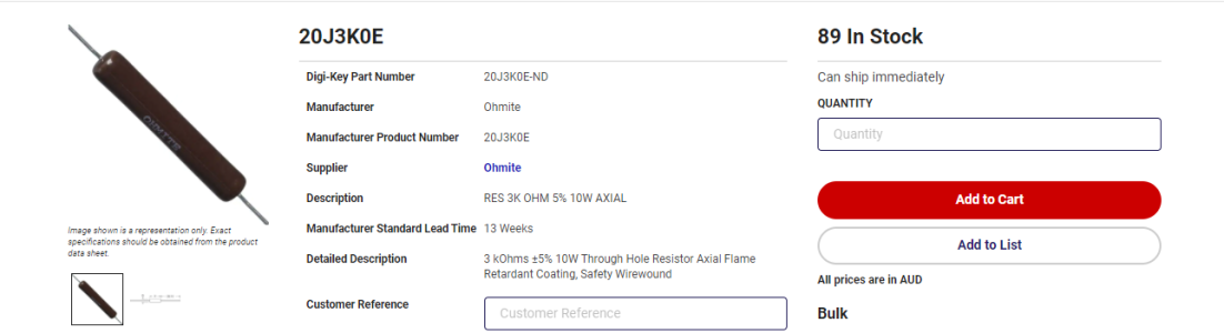

quick follow-up question.
I'm having trouble finding the exact same resistor that is available to ship. I would have to wait till January.
I found these, will they work?
    • Posts: 20308
Reply #8 on: October 27, 2021, 08:59:52 AM
Those will likely fit the space.
