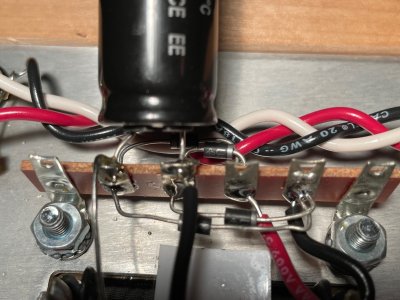

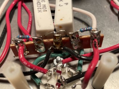

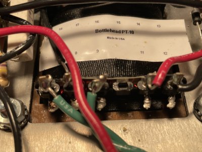

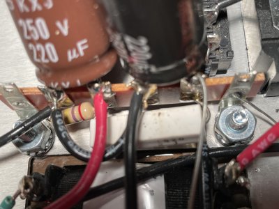

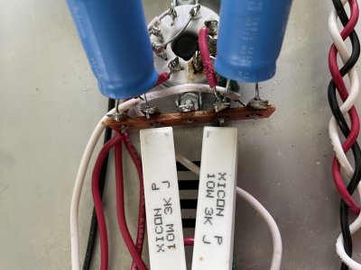

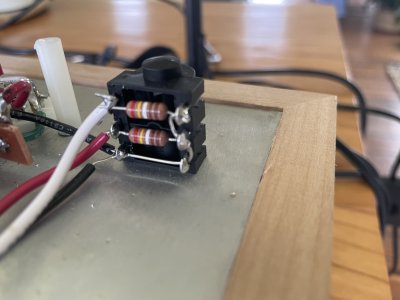

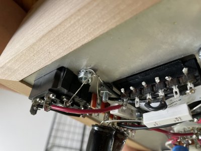

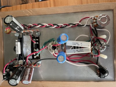

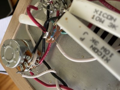

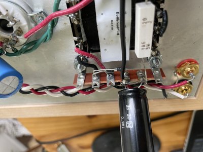

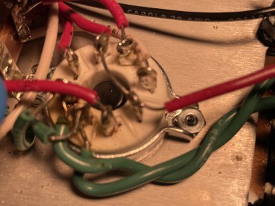

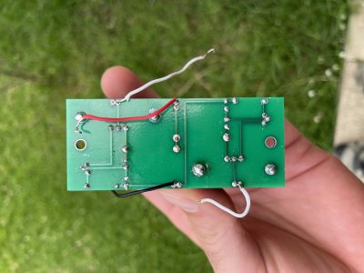

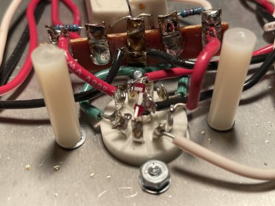

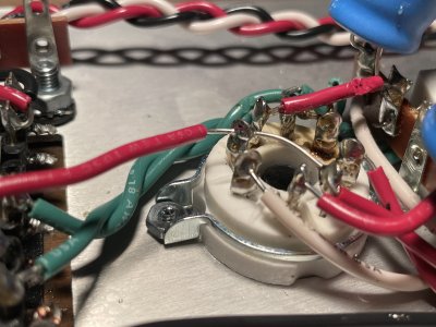

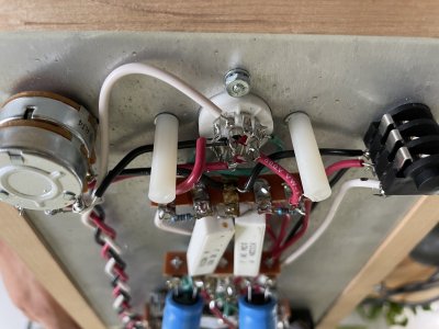

I've also uploaded some photos of the build. If you guys would be so kind and have a look at them in your spare time? Maybe you can point me to some obvious problems...

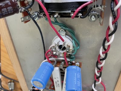

Michal,
Cheque the value of the 12AU7 plate load resistors, from the colour bands in your photo they look to be the wrong values.
Chris/AB2KH
Offline Thermioniclife
    • Posts: 818
Reply #2 on: October 28, 2021, 11:17:15 AM
Those resistors are 22k they call for 22.1k.
100 ohms one way or the other is probably fine.
    • Posts: 20308
Reply #3 on: October 28, 2021, 11:27:38 AM
the sound is kind of muffled and without separation.

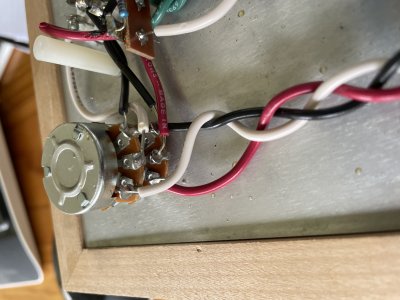

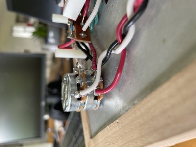

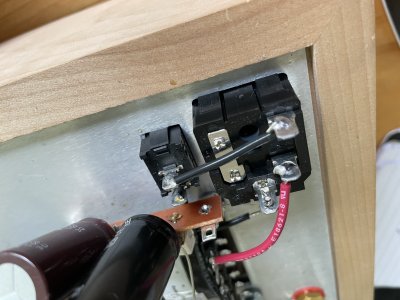

This is what I would expect from problematic solder joints.  When building a kit, it's important to attach wires and components to the terminals before soldering so you have a mechanical connection at work before the solder is applied.  If you just slip a wire through a hole and solder over it, then you are often relying too much on the solder itself to do the job, and these problematic connections will loosen up over time.
As an example, the wire going into A7 is a decent example of what we don't want, while the wire going into B3 is bent up vertically and sits against the terminal, then solder has been flowed all the way over that, which is great.
If both channels are muffled, chances are you have a soldering problem along the path the black wires make from your RCA jacks back into your power supply.

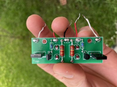

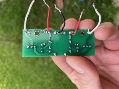

Also, can you see anything wrong with speedball plates? I wasn't planning on redoing them, I figured that maybe I didn't like the speedball upgrade because of the issues I have with the stock crack not sounding right.

Offline AB2KH
    • Posts: 47
Reply #5 on: October 28, 2021, 12:24:32 PM
Michal,

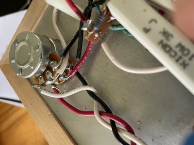

Are the two lugs on the volume pot where the black wires are connected tied together ( top and bottom )?
Chris/AB2KH
Offline luczamic
    • Posts: 16
Reply #6 on: October 28, 2021, 07:02:37 PM
Hi Chris, thank for the reply,
Yes it appears they are (see photos)

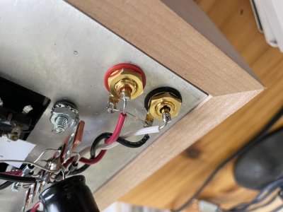

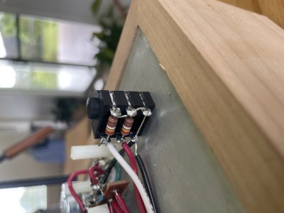

    • Posts: 20308
Reply #7 on: October 28, 2021, 07:05:35 PM
That's the HP jack, not the volume pot.
The 2.49K resistor that meets the white wire is not captured by solder.

I've also uploaded some better-quality photos so it's easier to see the mess.
PB, is there anything you could see obviously wrong with the Speedball plates? Thanks

    • Posts: 20308
Reply #9 on: October 29, 2021, 06:24:42 AM

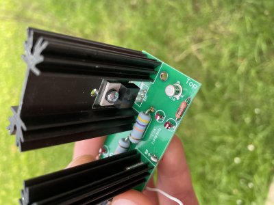

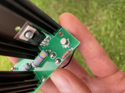

I saw at least one solder joint on your large Speedball board that hadn't flowed through the board.
If you have muffled weird sound from the stock build, you'd want to address that before listening to the Speedball, as a cold solder joint will cause sonic problems in either version of the amp.
