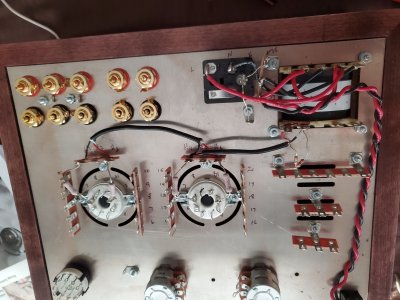

I am building a moreplay. I have come to the second stage of testing. My tubes are not turning on. Any thoughts?

Not having a Moreplay this is all I can do. Did you pass the high voltage test and the heater voltage test? If so what voltage do you get on pins 2&7 on the tube sockets with no tubes installed? If ok than what votage with tubes in place? Thats a good place to start.

The way you have your power transformer wired is not one of the options in the manual.

PB Having a second look at the photo after your post I see what you mean. In your words Nice Catch PB.

You also have 200 ohm resistors installed on the octal sockets which are not the correct resistors to use there.
