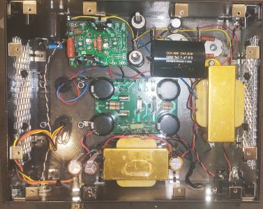

I have a set of Paramounts + the soft start upgrades that have been performing flawlessly for more than a year. Today, all of a sudden I heard a pop and smelled some burning (but music was still coming out). Shut it down, flipped it over, and it looks like one of the two power supply 1N5820 3A Schottky rectifiers blew (see pic attached). By inspection the rest of the rig looks fine. Should I just pop the power supply board (hints on how to do that would be welcome - it is soldered in pretty good!), and replace that part? Anything else I need to check/replace? Is there something I did wrong on install that I should look for/avoid, or is this just periodic component failure?

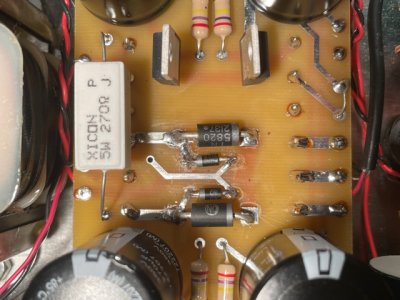

OK, so I replaced all 4 diodes (I used 2x 5818G and 2x5820G), see pic. A little ugly, I think. I took voltages and they are way off - B6 is 225VDC, A2 is >550VDC (and there was a strange noise when my multimeter probe touched that lead), and when I hooked onto that resistor hanging off the soft start board I got 90VDC.
