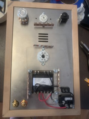

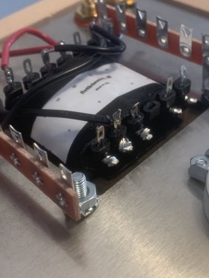

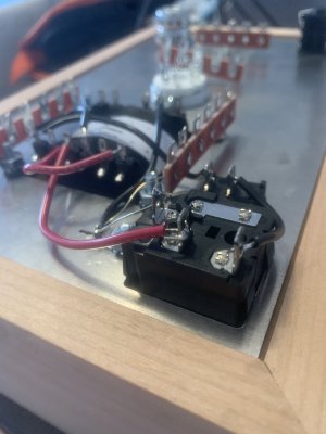

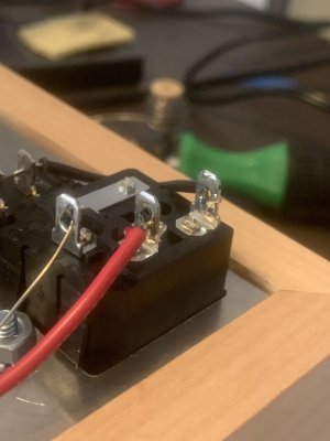

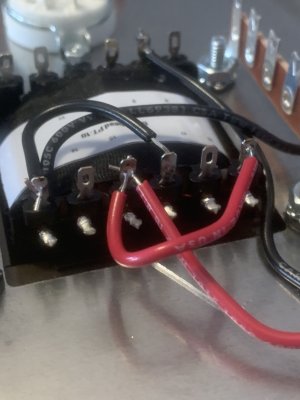

Hi Paul,
Thank you for the quick reply. Please see the attached photos. I checked all again and am reading 6v steadily at 7 and 9 and 119v between 16 and 18, as I saw you suggested someone test as well in another thread. When I hook up to 11 and 12 with the voltmeter at the 200v AC dial setting and plug in the power cord, the numbers quickly bounce but settle on 0.
The voltmeter is a $12 Amazon purchase AstroAI AM33D. I also checked the small red wires to each of the terminals of the transformer are not broken.
