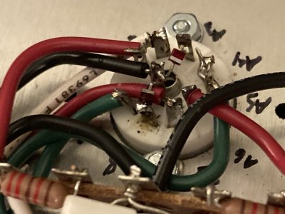

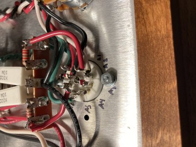

Given the proximity of my A8 LED to the solder joint, I suspect that reflowing A8 overheated and burnt out the LED.  I also see what appears to be some residue on the surface of the LED.  But given the manual's clear warning that the LED is often a symptom, I wanted to post here for advice before replacing the LED.

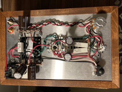

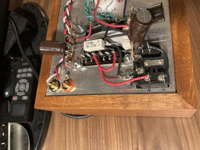

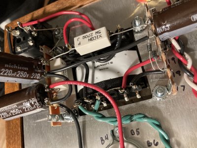

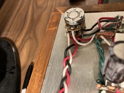

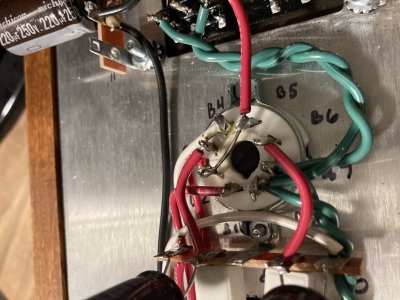

I've attached pictures of the build and have included my full resistance and voltage read-outs here.

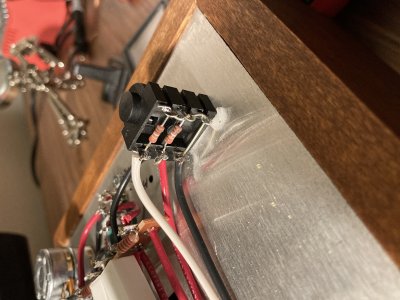

It turns out that my amp still suffered from crackling/popping/static after replacing the LEDs.  I carefully prodded around the amp with a wooden chopstick while running and found that the problematic connection was in fact on the headphone jack, on the bottom row of joints closest to the interior of the chassis.  I re-soldered that connection and the amp has been running great, so it appears that joint had been weak and probably jostled loose while tube rolling.
I understand this joint is a common point of failure, so...make sure to check it's solid regardless of where you think the problem is.  At least I've now got some more soldering experience with two fiddly LEDs.
