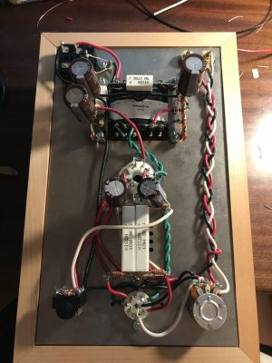

Hey there! Recently assembled the amp, and I have noise that comes mainly from the right channel. only new pot installed - ALPS RK27 Blue Velvet 250KOhm, everything else is standard. But there was the same noise with standard potentiometer installed :'(
The sound appears ten seconds after switching on and gradually increases regardless of rca jacks connected. Tolerable, but when nothing is playing, it's quite intrusive.
The soldering isn't perfect but i double-checked all the joints and it seems okay. Also i have no grounding in the house, but I use a Pilot XPro surge protector

Are the diodes on the transformer side positioned correctly? Even if they are they are very close to touching themselves and adjacent wires. See the manual. The white wire from/to the headphone jack isn't ideally routed. Certainly not per my Crack and the manual.
I've double-checked diode connection and its okay. About the fact that they are located close: is it worth insulating the exposed parts of the diode? As far as I remember in the documentation they are located just as close
