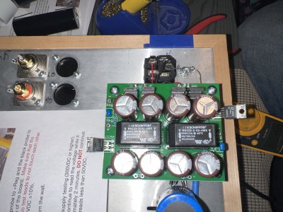

On the regulator PC board, there are two pads on each half of the board up front that have nothing connected to them.  What DC voltages do you get between those pads on each side of the board?
You haven't provided enough information to determine if anything is wrong with the regulators.  I would not do anything with them just yet.
Also posting some photos of what you've built and what you're looking at could also be helpful.

Can you tilt the board up to show the solder joints on the bottom?

I must have damaged the through plating of the board eyelet. I’m getting 8 VDC measured from the bottom of the board.

Yes, can you post some photos of the soldering on the bottom of the PC  board?

I soldered the wires into place and ran them to the solder tabs next to each tube socket. Took another voltage check…….6.3vdc on the money?.?.?.  This eyelets must have been damaged and putting the wire through made a better connection? Whatever the case the problem seems to have salved itself.
