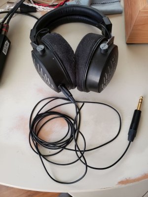

As fa as a headphone cable, Mogami W2697 from Performance Audio is a good choice @ 31 cents per foot. It has 3 conductors, a twisted pair wrapped with a shield but is very small diameter. I just made a cable for my DT-1990 Pro and it is excellent! (see photo) Really low capacitance. Completely busts the myth of needing thick wires for superior performance.
https://www.performanceaudio.com/mogami-w2697-miniature-balanced-mic-cable-by-the-foot.html
You could get 30 feet of W2697 for $9, and cut it in half for your 15 foot requirement.

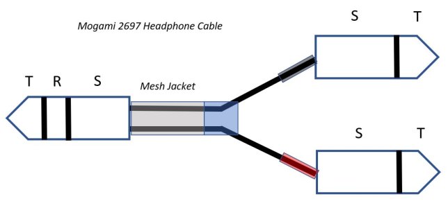

Get a TRS plug for the source and two TS plugs (or other 2 conductor plug) for your headphones. HiFiman is like this:
https://www.performanceaudio.com/amphenol-km2pb-au-3-5mm-ts-mono-mini-plug-cable-connector-black-gold.html
I didn't see you mention what headphones you are using.
Strip the source end of both cables and tie the all white wires and shields together and solder it to the sleeve on the TRS plug.
Solder one red wire to the ring of the TRS and the other red wire to the tip. Put a mesh jacket (have to figure out jacket size) around both cables up to the point where they split to the drivers and then heat shrink at the split point.
This 1/4 inch Techflex works great, fits 2 cables of W2697 nicely: https://www.performanceaudio.com/catalogsearch/result/?q=Techflex+Flexo+PET+Expandable+Braided+Sleeving+%281%2F4%22+Black%2C+By+the+Foot%29
Strip the ends of the of the other 2 cables and cut the shields away as they will not be attached.  Solder the red wires to the tips and the white wires to the sleeves of the TS plugs. Use red or black heat shrink at the TS plug on each cable to distinguish right from left. Check with meter unless you know which side is which.
What's left is a 15 foot premium cable with good shielding for less than 20 bucks. IMO, the DIY route is a great way to go for cables if you have the time to do it.

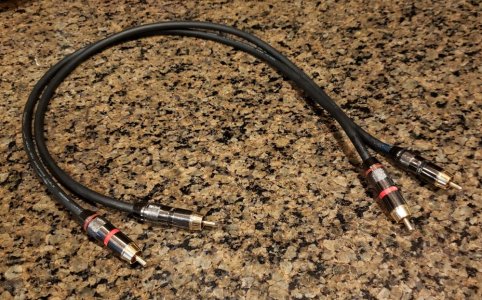

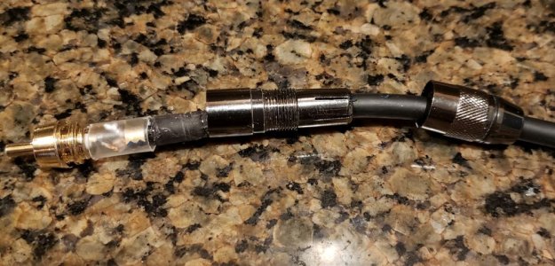

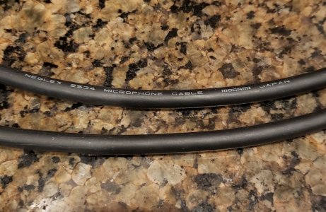

For RCA interconnects I really like Mogami 2534 (4 conductor + shield) and those Carter RCA plugs I linked above. The cable diameter fits the connector perfectly and the thing I like about the Carter connectors is the outstanding strain relief. Because of the 3 piece design, when you tighten it down, the cable is gripped and compressed by the middle section. It doesn't rely on just the wire ground clamp. You could literally have a tug of war with these cables pulling on the RCA ends when completed.

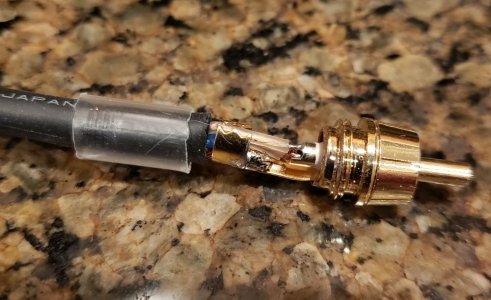

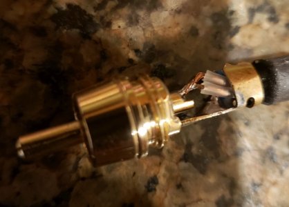

I usually twist the blue wires and shield together on one end and solder to ground. Then twist the clear wires together and solder to signal. On the other end I cut off the excess shield and twist the blue wires together and solder to ground, then twist the clear wires together and solder to signal. Then mark the cable (somehow, heat shrink, paint dot, etc..) to identify the end with lifted (floating) ground. I then attach the RCA plugs with the grounded ends to the source. If you dig around on the web there is information why it's done this way from World's Best Cables. I haven't had a single issue constructing cables this way. I've used RCA cables of all types with or without floating grounds and they generally just work fine. I am just in the habit now of building them floated.
