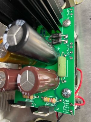

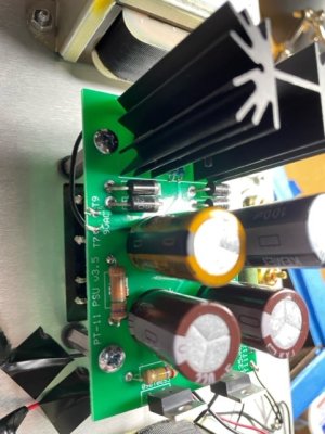

Attached pic of the board.

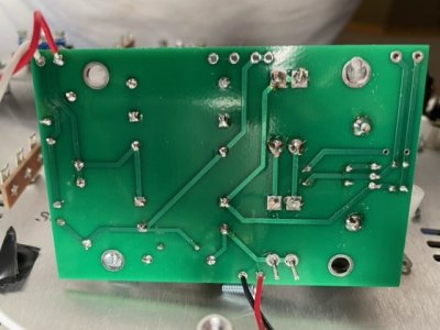

Attached the picture from the bottom.

May or may not be related, but I see two VERY long legs poking down from the bottom of the board next to your red and black wires.  Be sure they are not touching anything else below the board when it is mounted.  I’ve shorted more than one component this way….  ;D

Don't know if it is just the picture but it looks like one of the pads are not soldered or not soldered well (top left square pad, one of the diode leads)

Also be sure you have the 1085 regulator installed on that board and not an MJE5731A.

Paul I think you are right. Its the wrong one installed. I need to figure out how to desolder it.
Thanks - pretty sure this is the problem.
