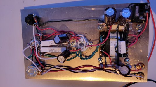

Hello! So bad news, when I measured the voltage of terminal 3 there was a big pop and some sparks flew. I tried re soldering the jack where the two black wires meet. Here are some photos of the build.

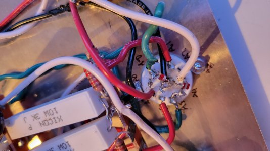

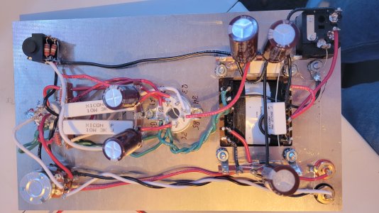

Here's some more photos.

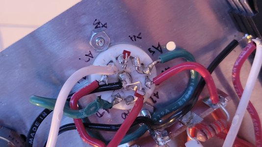

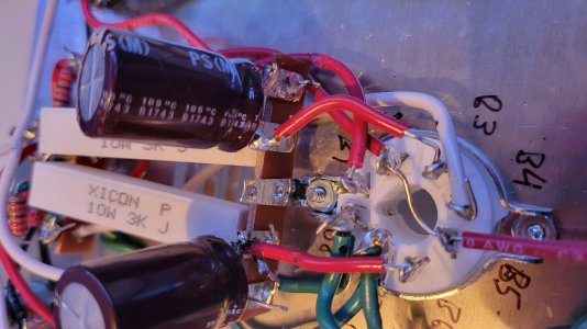

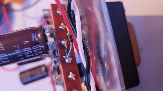

One more! Sorry for the spam but I'm having some connectivity issues with the forum, doesn't seem to be letting me put all the photos in one post.
    • Posts: 20300
There are on or more issues at work here.
1.  You definitely need some proper side cutters.  CHP-170 cutters are inexpensive and do the job well, and this will let you trim your leads back considerably.
2.  Possibly your iron isn't hot enough to properly flow your solder and/or
3.  You're using lead free solder.
Notice that none of this really has anything to do with skill level or experience, so rest assured that some adjustments to tools and temperature settings are likely all that's needed (and maybe a new LED or two).
