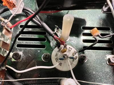

I completely removed the transistors in all the Q2 positions, cleaned the pins and resoldered them back in place, making sure to get enough heat to the middle pins. The end result didn't change, unfortunately, still no B side on the C4S'
I also removed all wires and resistors/capacitors from the tube sockets and resoldered all those as well. Man those 0.1uF 100v caps are a royal pain  :(

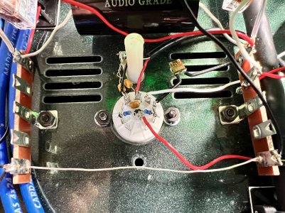

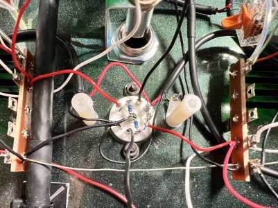

I then checked continuity across all those connections. to the boards, which checked out. Unfortunately still the same behavior with no B sides lighting up, and the B-side LEDs only lighting up above the C socket C4S if I turn the bias screw way up.  The A-side Kreg is still at about 4.5v, while the B-side Kreg is about 9.5v.
All the tubes do light up when powered on (pic attached). A few times I forgot to add a tube back in after resoldering the tube sockets, and interestingly the behavior of the LED lights on the C4S is the same; no B-side LEDs lit.
I had an unfortunate issue where some of the OA solder pad lifted while removing the bias board, but was able to push it back down and use 2nd pad next to it instead. All still seems good there.
Pics of the sockets are attached.
