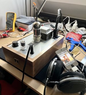

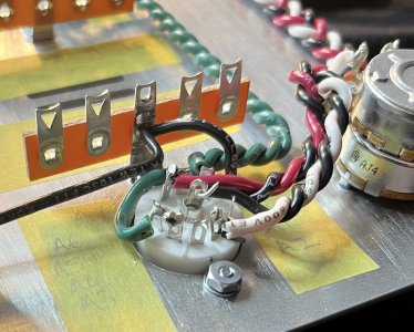

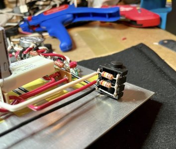

I've just finished my first BH kit - the Crack - and had to jump on here immediately to say thanks for making this possible guys. I got the kit for Christmas and I've taken my time building it, not wanting the fun to end really. And it really has been so enjoyable. Great manual to follow, too. I'm not entirely new to electronics, but it's been a while, and getting into the audiophile hobby has rekindled my passion.
It all went together well and tested fine. When I plugged my HD650s in, which I bought to pair with the Crack, and set Corrine Bailey Ray playing on my old iPod, I had goosebumps within seconds. Such a great sound! I had lots of upgrades in mind, but even though nothing is burned in yet (headphones included) it's got me wondering why I should bother, although I know I will. That's what the audiophile journey is about after all.

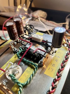

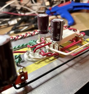

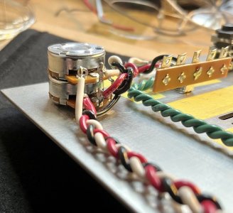

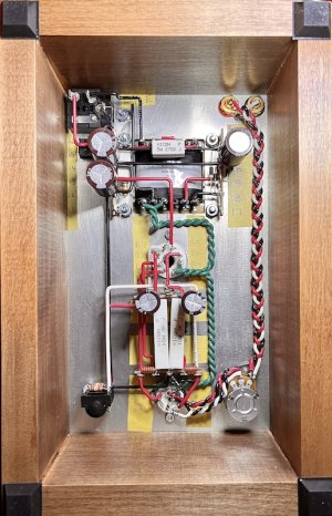

In case you're not yet tired of seeing Crack build photos, here are some of mine. The only variations I made were the wire colour choices from the IEC to the mains transformer primary, as being in the UK red is a hot/live colour and never used for Neutral. And I twisted the ground wires from the pot along with the signal wires to continue the common mode rejection. I have to say that I was amazed at how quiet this amp is, with zero audible hum or hiss even at max volume.
Another thing I was particularly impressed with was how close the HLMP LEDs matched one another in terms of forward voltage drop. Do you match them, or did I get lucky? They measured exactly the same.

Lovely specimen of a Bottlehead Crack.! Thanks for posting.
Offline eharent
    • Posts: 15
Reply #6 on: January 21, 2022, 03:20:49 AM
Hello there,
how did you manage to have the wires so straight ant tight. it looks amazing!
would have loved to do it this way :)
Best,
Emmanuel
Offline CrackMeUp
    • Posts: 25
Reply #7 on: January 21, 2022, 09:26:57 PM
Hello there,
Best,
Emmanuel

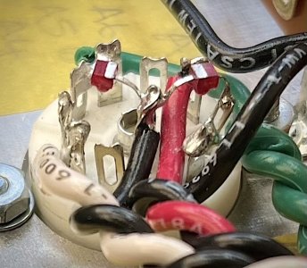

Hi Emmanuel, you have to go your own way with the wire lengths to position them like this. I attach one end before I cut, run the wire how I'd like it, including the bends etc, to the other end, then cut it 7mm past the termination to allow for that 7mm bit to be stripped. Tight bends on twists and braid are easy enough if you take your time. They're not long runs. One thing to watch with the supplied PVC wire is that the PVC can melt away pretty easily where you have a bend in the wire close to the solder point. I would usually try to solder those ends first where possible, keeping the wire straight until after it's soldered. Not always possible though if you're closely following the construction order in the manual. No problem with Teflon/PTFE dielectric of course if you use that.
