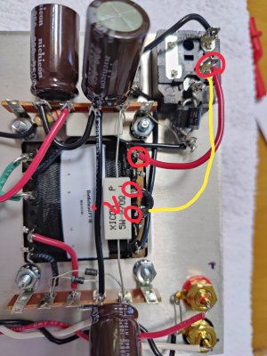

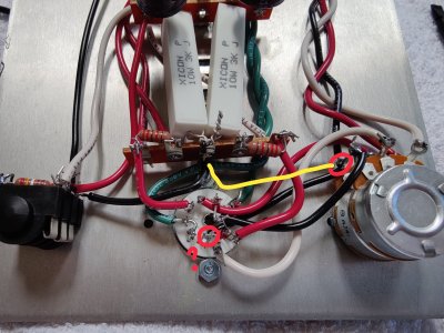

Ok, before doing a resistance test. I just did a visual inspection and found two things that don't look correct. I was wondering if these are something I should worry about and could also be a source of the problem?
#1
Red wire from N goes into #18 on the transformer when the photo shows it goes into #14. I've captured this in the photo where red circles are where it runs and yellow line is where it should run.
Also there's a small wire that plugs into transformer #16 and #15.
#2
Black wire runs from volume pot to A3 when it should run from volume pot to #3. I've captured this in the photo where red circles are where it runs and yellow line is where it should run.

    • Posts: 20257
Yeah, that black wire to A3 is a problem.
The wiring on the power transformer will depend on your incoming voltage.  You have your transformer wired for 240V mains, where do you live and what did you measure with your meter during assembly?
The joint at 16L needs more solder.
20L needs more solder.
21L needs more solder.

    • Posts: 20257
That black wire is not where it's supposed to be.  I would not plug the amp in when it's wired like that.
It's also not wired for 230V, which is a different configuration that is available.
I would send this back.

Ok, thank you. I misspoke, I'm in a 240v area.
I'm going to rebuild it.
    • Posts: 20257
Or you could move one wire and see if it works?
Offline Coldsnap
    • Posts: 18
Yea, that's what I mean. There's also that weird ground filtering mod too I will remove. And also solderer those bits.
