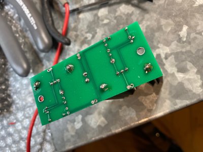

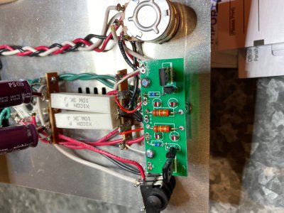

Offline eharent
    • Posts: 15

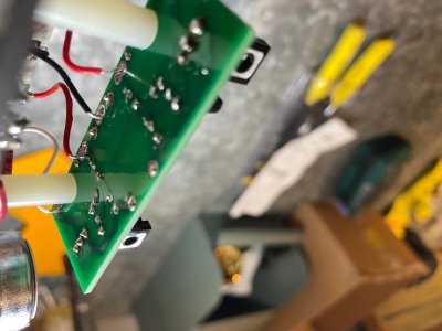

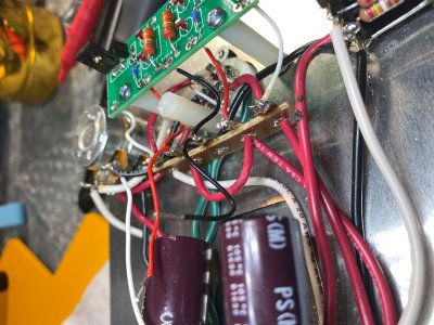

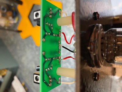

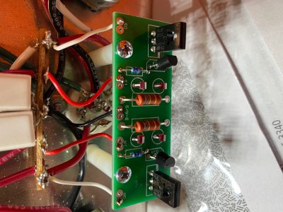

Reply #2 on: January 21, 2022, 02:39:04 AM
Hi Paul,
thank you for your prompt reply. here are some pics of the board. it is the first board to be installed and it is the smaller one of the two.
hope we can spot the issue! may be it is obvious to you?
thks again
Brgds,
Emmanuel  ;D
Offline bernieclub
    • Posts: 114
Reply #3 on: January 21, 2022, 04:11:59 AM
Q1b transistor looks backwards.
Bernie Zitomer
Offline eharent
    • Posts: 15
Reply #4 on: January 21, 2022, 04:15:50 AM
Hi Paul,
OMG so silly! thank you for spotting this. i will remedy this ASAP and do a check again. will keep you updated
thank you
Emmanuel

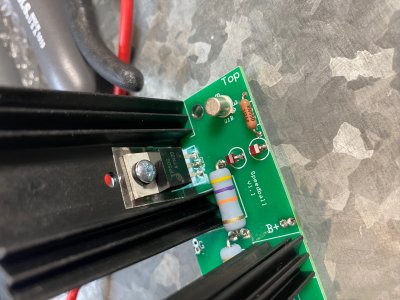

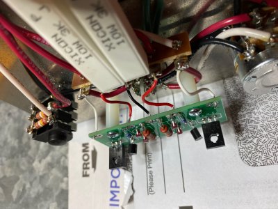

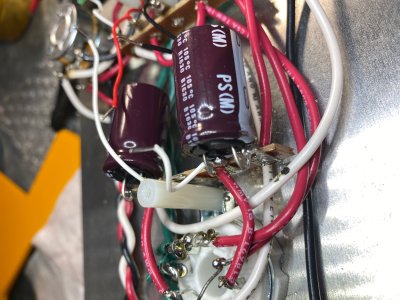

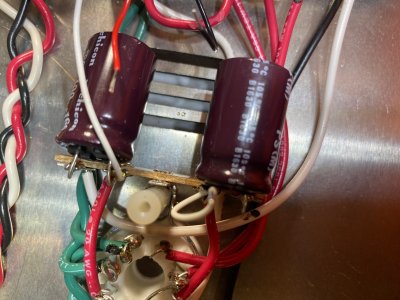

Offline eharent
    • Posts: 15
Reply #5 on: January 21, 2022, 04:22:27 PM
Hello,
just mounted the large board (pictures attached) and connected it. Positioned it on top as instructed and screwed it. just did the resistance check on OB and OA and i am not reading anything. the meeter stays at 0.L. i would appreciate the help!
thank you much
Emmanuel
    • Posts: 20299
Reply #6 on: January 21, 2022, 04:23:54 PM
OL means over limit, which is what you are supposed to see at those terminals.
I would reheat the solder joints on those 47K resistors until the solder flows through the board.  Definitely do not solder both sides of the PC board, as it's important to heat these joints up enough that the solder flows into the hole all the way and comes out the other side on its own.
