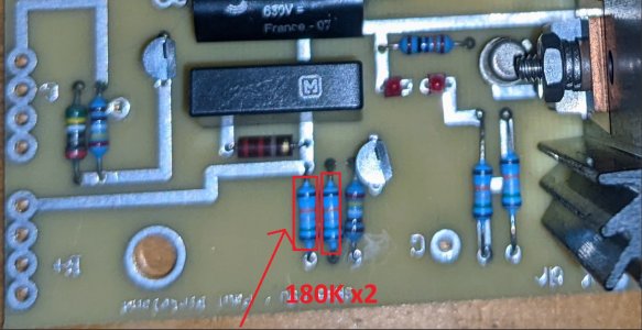

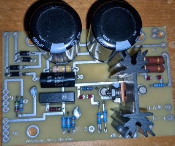

Did I sell you a blank board or a populated board?  Can you post a photo of what you have?
Offline ssssly
    • Posts: 386
Reply #10 on: January 22, 2022, 03:49:14 PM
Populated.
Reply #11 on: January 22, 2022, 04:39:53 PM
I'll confess that I just tweaked my SR45s to be more like the Stereomour in 45 mode and called it good.
You'll have to change the two resistors I've pointed out on the boards to 180K 0.5W (1W is OK too, PR-01 would probably fit). This will set the B+ to 360V.
The cathode resistor should be increased to 1.6K 6+W rated.

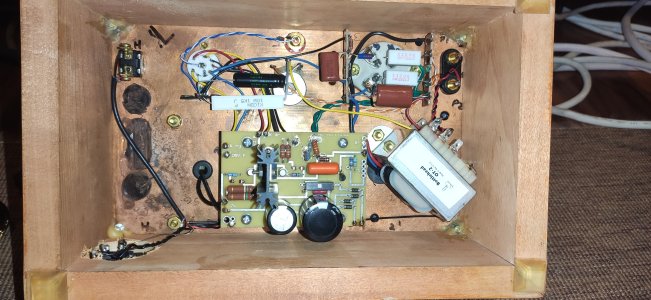

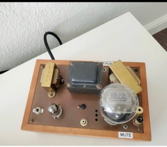

I also attached a picture of my (kind of ugly) SR-45 insides built on some recycled copper plates.  I happened to have a 360K/1W resistor in my inventory so I used that rather than the 2x180K resistors.

Is the OT-2 oriented at that angle for space or noise rejection?
Reply #13 on: January 22, 2022, 07:15:21 PM
It's oriented where the existing holes were ;)
Those plates were quasi-Paraglow amps that ended up getting parted out.
Offline tsingle999
    • Posts: 275
Reply #14 on: January 23, 2022, 04:00:49 AM
Nice looking amp Paul! I love the copper plate. Looks like you have some nice mq iron in there too! But the nicest thing is the metal power switch;)
