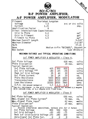

And an 8K MQ output to find something to do with.
    • Posts: 5908
Reply #9 on: January 26, 2022, 06:49:46 PM
I thought of the 10, but it only goes up to 425v - didn't follow up with the 801!
