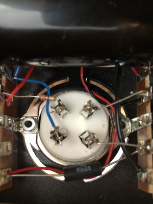

Getting a reading of 2.375V or 2.37 on two different meters reading EH gold grids in circuit and AT THE TUBE PINS, not the bottom of the socket at recommended in the links below:
http://www.emissionlabs.com/Articles/TECH-BULLETIN/TB-05-Heater-Voltage/TB-05-Heater-Voltage.html
http://www.emissionlabs.com/datasheets/EML2A3-mesh.html#Notes
Now normally I'm not gonna get to bent out of shape over a 5% low heater voltage as I have a couple pair (can't find the third pair I bought over a decade ago) of EH Gold Grid tubes and they aren't THAT expensive anyway.
As I am thinking on a pair of EML Mesh Plates at $800 a pair, maybe, based on the links above I should be a bit concerned?
AC line voltage here is 119 VAC and it does not vary more than a volt or two either way ever.  We have our own transformer at the street serving only our home.  Newer homes around here have to share but we have one just us.
The Transformers in the MonAmours is strapped properly for 115-130 VAC so that should not be changed I'm guessing?
I see an 8R10? resistor in series with the filaments(heater)?  Any idea what I could change that value to in order to get 2.5V +/- a percent or two at the pins, in circuit, based on the fact that I'm currently reading 2.37V?
Thanks.

And we're good.
Turns out I'v got 122VAC this morning at 11:00am (usually listen/work on things in the evening so doubt I've ever checked mains voltage in the morning.  Always read 120VAC and usually one lower or one higher.  Maybe just high when the sun is hitting the solar panels?
But...
In circuit, on the pins of the 2A3, I'm now getting 2.42VDC ( instead of 2.37) and am measuring .051AC (RMS?), and that's on two different tubes, one Russian and on Chinese, for a total of 2.471 volts across the heater pins on the tube and I am at +/- 1% and all is good.

Both AC and DC with a meter as my scope is uncalibrated.  On the pins of the tube with tiny probes while under power.
But, as the voltage range of the transformer strapping I have mine set to is 'more than 115VAC and less than 130VAC', and there is no real regulation in the 2.5 VDC supply, some serious variation should be expected.
So, if one is really serious about 2.5VDC +/- just a couple percent, not 5% as was the rule in olden times and if one can keep their OWN AC line voltage at a reasonable +/- from a given number (say, in my case 120VAC) than it looks like maybe custom selection of the value of the current 8R10 3W resistor might do the trick?
Looks like its a high quality part (Mills?) and maybe even a high precision part?
I'd be more than happy to acquire a few and willing to futz around with it if you could give me some guidance as to where I might start to pick up just .1VDC or an increase in DC voltage of about  3%?

 By the way, the series resistor is 0.1 ohms, not 8.1 - there's a slash through the zero to distinguish it from the letter O. Sort of an engineering-geek font. You could get some more and parallel the one that's there and measure the change.

Yep, eyes are getting old.  0R10 3 Watt it is. And looks like Mills sells 0.1 5W that looks pretty close to what is in there.  Plus lots of sizes like 0R12., 0R15 and 0R18 which can be paralleled up for an endless combination of resistances, on of which might get us closer to 2.5VDC.
And yes, first measurement was 2.37VDC in the evening after on all day and the other measurements(more like 2.42VDC) were in the morning with only 15-20 minutes of warm-up BUT then the line voltage was different in the evening vs. the morning by about 1-2 percent as well so... Fortunately the range of line voltage in that room is 'only' from 119VAC to 122VAC but I'll start keeping better track of that as well
Just got to get it closer to 2.5VDC on average and if it goes a couple percent over to 2.55VDC or a couple percent below to 2.45VDC from time to time we can call it good!
