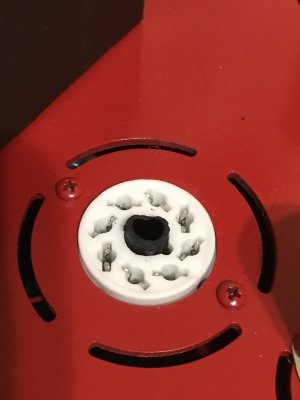

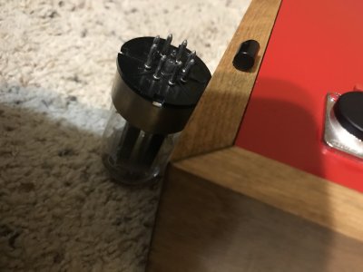

Hi All,
A funny issue happened with my C2A the other day. I started it and there was a LOUD hum straight away and the shunt tubes also started to turn a bit blue.. Fiddling around, I see the plastic center cap of the signal tube had broken off and was wedged in the socket!! Have never seen anything like this before :) Attaching a few pics for fun.. Anyways I dug out the plastic trapped and replaced the tube and it is back to good music once again..

Reply #1 on: February 06, 2022, 05:10:47 PM
Do you have a cat. ;)
Offline Happy Ghost
    • Posts: 166
Reply #2 on: February 06, 2022, 05:29:22 PM
Yeah.. three cats actually .. but they all like Bottlehead :) no incident for 3 years
