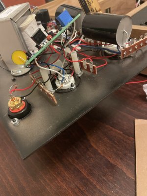

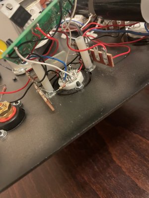

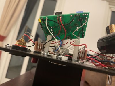

I would unscrew the board and carefully tilt it up so you can show a pic of the bottom side, as well as how it's wired into the amp.
Offline Suger
    • Posts: 54
Reply #6 on: February 11, 2022, 05:36:39 AM
Are these good enough?
    • Posts: 20144
Reply #7 on: February 11, 2022, 11:40:49 AM
For all the solder joints other than the ones with LEDs, you can apply a whole lot more heat.
On the 9 pin socket, it is not permissible to wrap connections around the sides of the socket pins.  You can wrap them up and over, and there's a little depression in the top edge of each socket pin that will keep the leads in place for soldering.
The presence of proper ground and proper IA voltage but nothing on OA either means you have a major short pulling OA down, or soldering problems.  The short condition would also come with snaps, crackles, and pops, so I would be more inclined toward the soldering issues.
