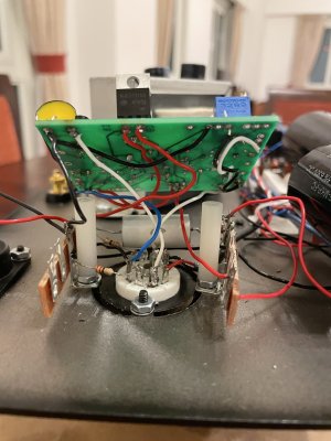

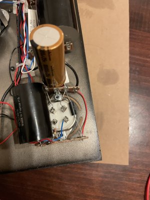

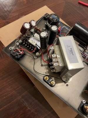

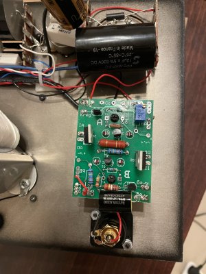

Can you post some photos of this build so far?
Offline Suger
    • Posts: 54
Reply #2 on: February 18, 2022, 06:33:40 AM
Here you go

Can you post some photos of your build of the board with the 431s on it?
