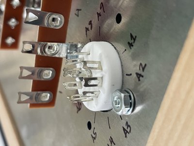

VERY stoked to finally be working on my kit - it's been a pleasure so far. Last night I installed all the hardware to the chassis and labeled the terminals. Before calling it a night, I decided to pop the tubes in - the idea being to confirm the sockets were adequately fastened to the chassis NOW, rather than after they've got a buncha stuff soldered to them.
The octal is a fairly tight fit, but the big guy wiggled its way in. Pins seem in good mechanical contact all-around.

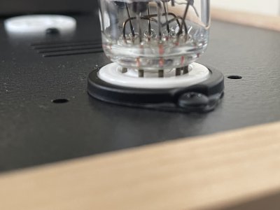

The 9-pin is a different story. It took what seemed like WAY too much effort to get the 12AU7 in there. I did manage it - VERY carefully - stopping short of getting the tube totally flush with the socket. It feels like 2 or 3 holes are way too small, and the holes opposite them don't seem like they're in good contact with the pins at all. For all the effort inserting it, the tube still wobbles around in the socket!
At first I suspected the tube vs the socket, BUT: The 12AU7 from the kit fits happily into a 9-pin socket on my Manley, but a spare 12AT7 that I know fits in the Manley won't go into the socket on the Crack, either. SO... did I crank the bolts too tight? Do these sockets need to "break in"? Or I have a bad one?
See attached - note that at one point I had the tube farther into the socket, but I opted not to go that far when I put it back in for the photo - I was actually worried I might break the glass!!
THANKS for any help!

Some of the newer tube sockets I've worked with are indeed a bit tight.  I think you'll find that the kit will work OK with the tube pressed in that far, and that the socket will loosen up a little over time.
In order to open the socket up, you would need a tool with a shaft diameter that's just slightly less or exactly the same as the socket pins, and that can be tough to find!

I'd certainly make the pins shiny with some 1000 grit (or finer) paper to help them a bit. I don't know what the official pin size is but the shank of a drill could be used. A drill slightly smaller could also be wriggled in the socket too but don't overdo it. Sockets are inexpensive but if you go to Bottlehead for a replacement perhaps they could check it with a tube before sending it out.

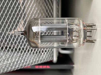

But while I have your attention, I'm curious about the 12AU7 that came with the kit. Any markings are now likely on the sticky side of the bubble wrap it came in, if it had any. Photo attached, note the flash is concentrated on one side of the top. Can you ID it so I've got a reference?
Reply #10 on: February 25, 2022, 02:26:59 PM
There might be faint etched lettering saying 12AU7 or a mil number like 5814 or 5963 on the glass, most likely near the top. If I could see that I could guess. I'm not enough of a geek to be able to identify it by plate structure alone. There sure might be someone around here that could, though.
