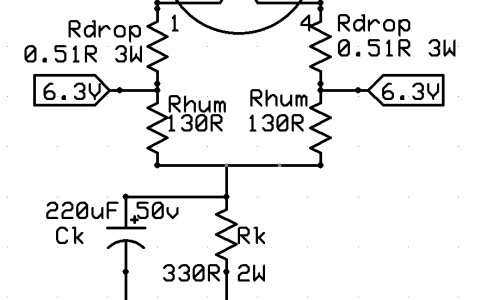

Guess I'm having a problem understanding the schematic in the manual I downloaded a few weeks ago when I ordered.
It's a .pdf and my free version of Adobe won't let be post a picture but...
It doesn't look quite right.   It's the schematic that has me confused.  Looks like the 130 ohm resistors are attached directly to the socket pins.
Even left and right side of the filament are different and while I agree with what you you say as the resistors do go directly to the pins of the 300B as I assembled it the schematic is confusing.

Reply #5 on: March 06, 2022, 12:53:22 PM
Yes, the resistor values are swapped in the schematic, but correct in the assembly directions and all the photos of the build.

Reply #6 on: March 07, 2022, 04:24:50 AM
That was my guess but still...
And assuming that, as the left and right side of the filament circuit in the schematic are wired differently, at least on my schematic, that the left side is the way it should be drawn out?
If that's the case, it look to me as if the Regulated  6.3 V comes in on the outside end, away from the  filaments, of the 130 Ohm resistors and then attached to the two filament pins through the .51 Ohm resistors?
A better drawing would help but I am assuming the purpose of the two 130 Ohm resistors is to drop the voltage from a regulated 6.3V to the 5V that the 300B would like to see?
And if the 6.3V is indeed regulated at 6.3V then changing the 130 Ohm resistors would change the voltage on across the filaments?
A more accurate drawing might help me understand and I might be missing something?
    • Posts: 20204
Reply #7 on: March 07, 2022, 04:42:48 AM
The 0.51 ohm resistors drop the regulated 6.3V to 5V.  The 130 ohm resistors create a center tap for biasing.
Then there is clearly an error on the schematic in my manual as to where the 6.3V is applied even with the resistor value swap.
    • Posts: 20204
Reply #9 on: March 07, 2022, 05:55:41 AM
There is an error in the schematic.  There is not an error in the manual.

Reply #10 on: March 07, 2022, 06:21:36 AM
Thanks, that's exactly what I was looking for!
Makes all the sense in the world now.
