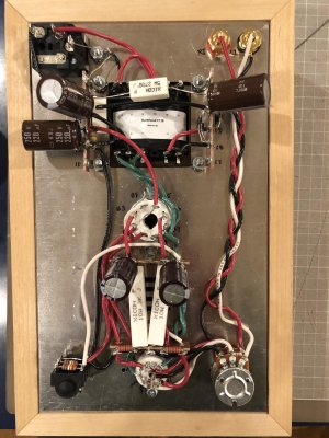

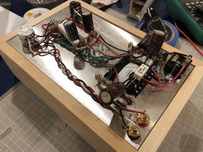

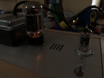

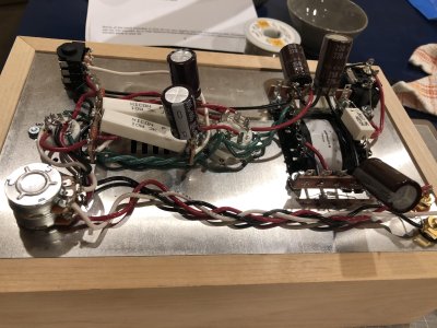

A few photos...

Reply #4 on: March 12, 2022, 04:10:58 PM
Are both the black wires on the headphone jack captured by solder?
Your voltages being what they are would not indicate that the LEDs would be illuminated, so I would suspect a loose ground wire in the amp.
LEDs illuminate within 10 seconds of the amp getting power. Both tubes glow, both sides.

    • Posts: 20178
Reply #10 on: March 13, 2022, 09:28:52 AM
Pull on each black wire with a needle nose plier (with the amp off and unplugged).  It's likely that one will either pull completely out from where it's sitting or will move a lot more than it should.
Alternatively you can heat up your soldering iron and reflow all of the joints on all of the black wires that work their way from the RCA jacks to the volume pot, then to terminal 3, then to the headphone jack, then back up to the two 6 lug strips at the rear of the amp.
