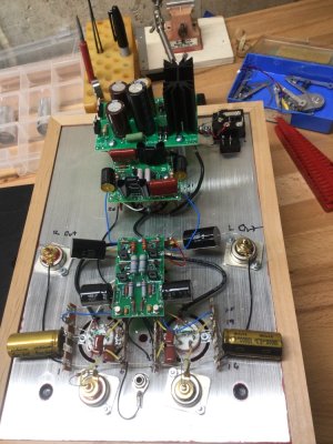

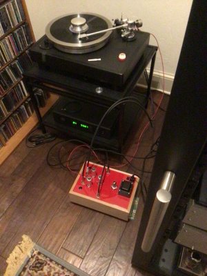

I finished up the Eros 2 Phono Stage last week, and I have been playing records by pairing it with my VPI Classic I with a Sumiko Blackbird High Output MC Cartridge.  I'd like to thank Doc, PB and PJ for designing and making this kit available.  I loved building it, and it sounds wonderful.

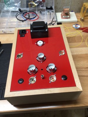

Now, just a word of warning to anyone about to understake the build:  I inadvertently had the wrong side of the chassis plate powder coated.  Compare the plate to the photograph and make sure the openings in the plate for the power switch and IEC inlet are on the correct side.  I have proved that you can successfully build a left-handed version, but as PB points out this is probably the only Bottlehead kit that you can get away with doing this.  Also, there are two 10,000uF 6.3V electrolytic capacitors that hang off terminal strips detailed on page 59 of the instructions.  The ones I got supplied with the kit are apparently quite a bit longer than those shown in the instruction manual.  This necessitated bending the caps down instead of a right angles to the terminal strips.
Otherwise they would hit the enclosure when you mount the chassis on the wooden box.
The only thing I have left to do is sand, stain and lacquer the wooden enclosure.  Pictures below.
John

I'm glad everything ended up working out properly.
The normal 10,000uF caps we would provide for that position are out of stock until the fall I believe, hence the substitutes that function but are a bit of a tight fit.
