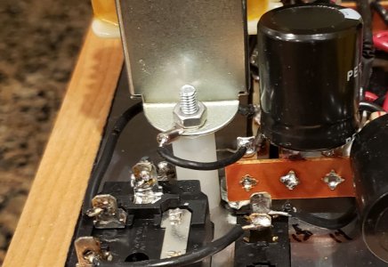

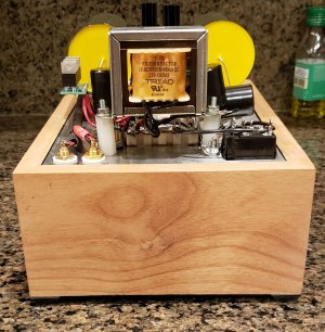

I used these 25mm nylon spacers from Mouser and very happy with the fit of the choke. Better yet, the amp is dead quiet.
https://www.mouser.com/ProductDetail/Schurter/9642.5200?qs=vD8Ch%2FBYqOgD22lREtUw1A%3D%3D&countrycode=US&currencycode=USD
I wanted the choke to be isolated from the plate.
Needs M4 bolts for attaching to plate.
I then ran a a ground wire from the Choke mounting bolt to Terminal 16.
Choke wiring was to Terminals 15 and 21.
One has to be careful when drilling holes. The are awfully close to the transformer.

That looks like an eligent solution  :D...John

You are too kind John ... I am like a bull in a china shop and ham-fisted. It's a bit ugly inside, looks respectable outside (I think) but most importantly sings like a canary.  :P
