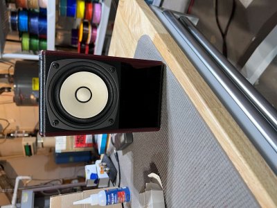

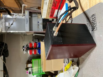

Just for kicks I 3D printed a speaker design I found on Thingiverse, https://www.thingiverse.com/thing:4750820
I used Fostex Fe103NV's as the drivers and printed the parts with Atomic Extreme Carbon PETG.  I printed them at a fairly high infill of 60%.  This made for a fairly dense cabinet but a very long print, about 90 hours for the body.  They actually sound much better than I thought they would.
So far, I have just printed one speaker, printing the second on now.  I'll post a picture of the cabinet without the side panel when it finishes printing.
Debra

Debk, you are an inspiration - I am trolling thingiverse at the moment, looking for speakers to give my dusty 3D printer something to do.
Did you print the sides in a different color of the same material, or was that painted?
Offline debk
    • Posts: 658
Reply #5 on: March 31, 2022, 02:22:46 PM
The sides were printed in a different color
