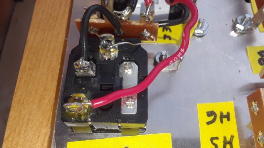

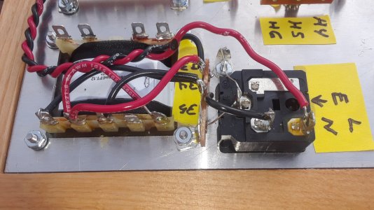

with my Moreplay build and sure could use some help.
I got to the Power Transformer Secondary Test a week or so ago thinking that everything was going well, but I was wrong.
When I did the initial powerline voltage test, I got 112.1 volts which seemed O.K. I then wired up the power supply for 110-130 volts.  Everything went fairly well up to the power switch test which turned out to be me not knowing how to use a dmm properly, but ccmccull got me straightened out in short order...Thanks!

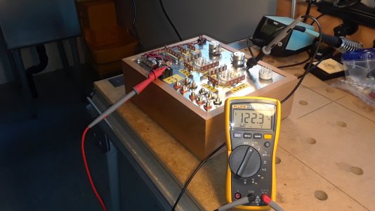

My secondary test gave me results of 0.0 volts for PT 6 and 7, and 0.048 for PT 9 and 10. At that point I went back and checked all of my joints, etc., and nothing seems amiss. Then I decided to do some other checks, so I checked the voltage at the wall socket which turned out to be 123.6 volts. What? I said to my self. I then rechecked L and N. Power switch on gave me 0.052 volts, off gave me 4.42 volts. I then checked with red on L and black on E, and I get 123.6.  So, my chassis plate is hot.

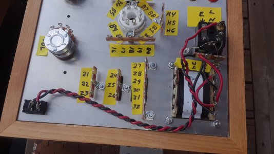

I dunno. Any ideas on what I screwed up? I will try and post some pictures.

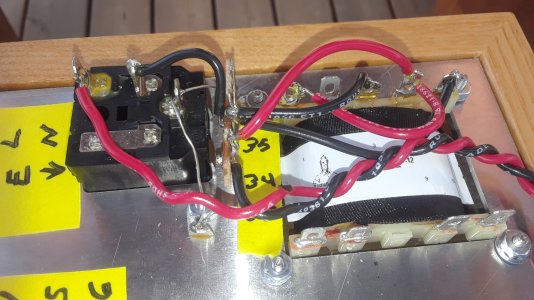

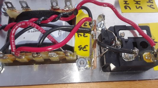

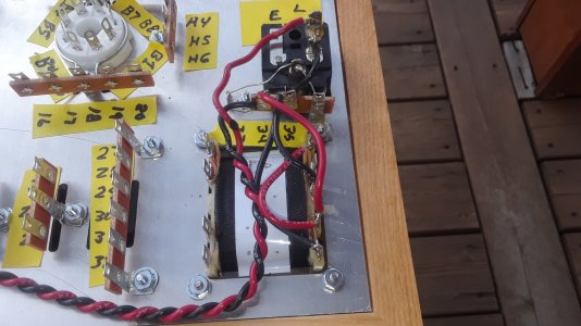

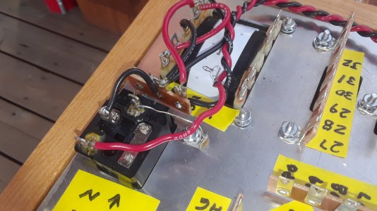

By your own checks, the neutral connection appears to not be making it to the power transformer, so I would check to be sure that black wire is well soldered on both ends and that the wires leaving that terminal and going to the power transformer are also well connected.

You can also put one meter probe on the N terminal on the IEC and measure the resistance between that point and all the wires going to it.

Paul, I did what you suggested and checked the connections with one probe on N and then went through all the rest of the neutral connections. Resistance was 0.1 on all connections, which matches what I got with your wire in general. I also checked using my continuity function and all seemed well.

How about AC voltage between N on the IEC inlet and each of the wires on the power switch?

With the black lead clipped to N on the IEC and the power switch in the on position, I get 0.05 AC volts on both the red and black connections at the power switch. With the power switch in the off position I still get 0.05 volts on the neutral, and 6.4 volts on the red connection.

If you are unable to get the 120V when your meter probes are on L and N on the IEC power entry module, I would suspect an issue with the power cord itself potentially or maybe an open or flaky neutral in the power outlet.   I would grab a three light tester from the hardware just to be sure the outlet is OK.  If you have a random IEC power cord sitting around, it wouldn't hurt to try another cord.

I don't have a three bulb tester handy, but I do have a couple of extra power cords. First I tested the cord supplied with the kit (with the probes simply stuck in the ends) at three or four different outlets on different circuits and it gave basically the same reading at all of them. I then took the amp to a different outlet and got the same readings as before. I then switched out cords (known cords that do work for sure) and I got no voltage at all, 0.0 volts AC., through either cord. They seemed to seat properly (actually better than the original), but no juice for some reason.
