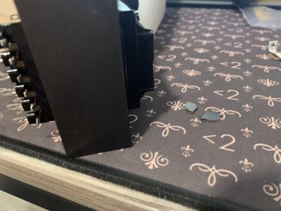

The plastic part on the power transformer broke off on each side, I was wondering if the transformer would still work or if I need to get a new one. Here's an image of the transformer
https://imgur.com/a/nTlT5Ue

It will work just fine.
How did you do that?!?

"Cosmetic". Reattach with super glue or epoxy.

I wouldn't bother reattaching it, that bit of the bobbin doesn't serve much of a purpose after the transformer is manufactured.
