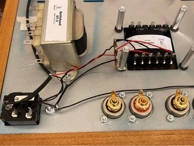

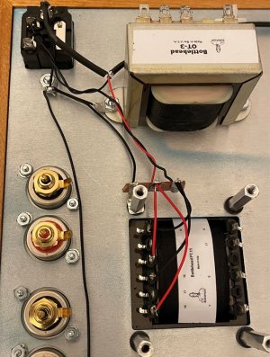

Could you post a quick photo of your transformer wiring?
Offline monteiro.sheldon
    • Posts: 13
Reply #2 on: April 16, 2022, 12:12:33 PM
Attached pics, thank you
    • Posts: 20282
Reply #3 on: April 16, 2022, 01:15:10 PM
I would reflow the solder joint at terminal 16 on the power transformer.
