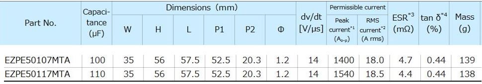

I am having a really hard time finding Panasonic caps EZP-E50107MTA that are used in the Crack.
I have located some 110uF Panasonic EZP-E .... EZP-E50117MTA.
Can I use this in the Crack and would there be any negative issues with doing so? Thank you.
I attached a chart of the electrical specs for both.

110uF is just fine.

Reply #2 on: April 29, 2022, 06:37:55 AM
Great, thank you!
