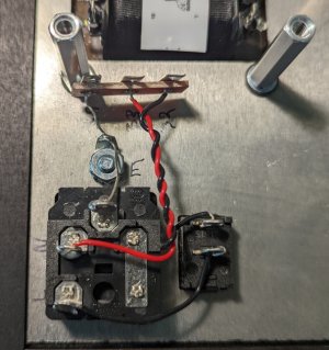

Just completed the incoming voltage test and I'm getting a solid 120v when the switch is "on" but 9.8v when it's in the "off" position. Is this normal or do I have a faulty switch?

Your meter is just picking up 60Hz noise.
