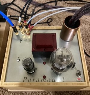

Offline Gerry E.
    • Posts: 192
Reply #2 on: May 10, 2022, 09:57:41 AM
They are cosmetic.
Is this true for all BH component PTs including my early version Paramounts?  I never cared for the candy-apple red that the original owner/builder painted the PTs (see attached photo).  If I could still use the amps with the PT covers off that will give me some time to strip the original paint and re-paint them.  Thanks!
Gerry
    • Posts: 20292
Reply #3 on: May 10, 2022, 10:07:01 AM
No, the Monamour has aluminum shrouds that cover the power transformer and those are cosmetic.  The steel end covers protect the windings from damage, so I wouldn't recommend not using those.
