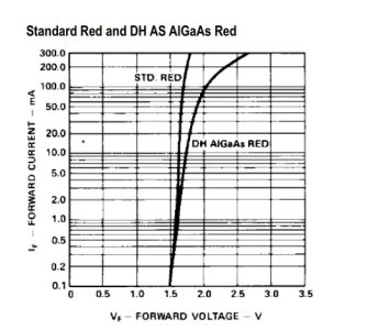

Here is the voltage vs. current curve for the HLMP-6000 (it's on the standard LED line).
If we have 3.2mA of quiescent current flowing through the LED and maybe our AC signal changes that by +/-1mA, you are moving up and down on the portion of that line that's nearly vertical, and so the voltage at the cathode remains nearly constant (I suspect there is some wiggle in the thousands digit if you looked closely enough).
