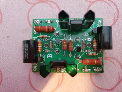

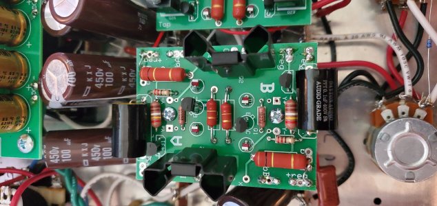

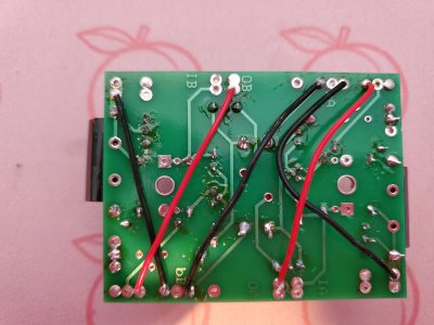

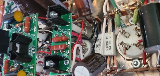

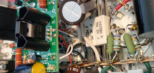

Offline thoven0215
    • Posts: 54
Reply #10 on: June 16, 2022, 09:31:49 AM
Sorry for the late reply, I had a nasty case of the flu. I rechecked the back of the board and noticed I did solder a wire to the wrong spot. I fixed it and here are some pictures of the back and front. Is there anything I've missed?
Sihwan
    • Posts: 20239
Reply #11 on: June 16, 2022, 10:19:54 AM
I would give it another shot.  Do you remember which connection wasn't where it was supposed to be?
Offline thoven0215
    • Posts: 54
Reply #12 on: July 03, 2022, 11:57:14 AM
Yes, I put it in the hole above OB (when you orient the letters correctly). I tried soldering everything back in and testing the voltages, but it started smoking. I unplugged and saw that it seemed to be the resistor next to the capacitor on the B side of the board that was smoking. It appears cracked now. What should I do?
