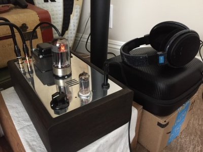

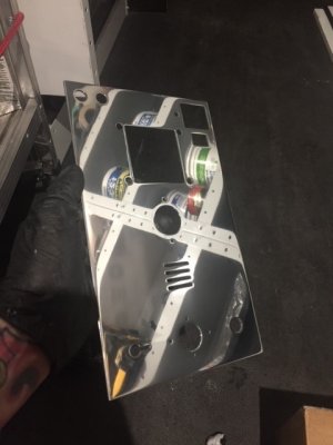

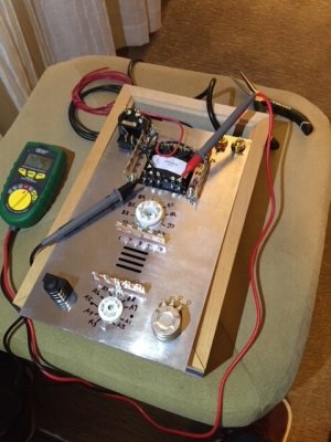

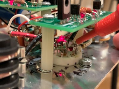

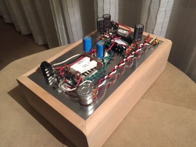

Here are some pictures of my Crack build. I built my Crack at the very end of 2016 & into the beginning of 2017.
My wife was pregnant with our now almost 5yr old. So while she was laid up on the couch not wanting to do a whole lot I setup my work station in the living room with her & worked on my amp.
I sanded down & buffed out the top plate to a mirror finish. I really should buff the top plate out again & maybe clear coat it so I don't have to keep on top of it. Right now the top plate looks ehh not so shiny. Its just that the amp sounds so good I don't want to mess with it.
Anyways, here are a few build pics as PB requested :)
    • Posts: 20296
Reply #5 on: June 01, 2022, 03:56:23 AM
Build pics would be what the amp looks like now, not what things looked like as you assembled them.

Ok got a few quick minutes to check the recommended terminal voltages. Here is what I got:
B1 = 81v
B5 = 171v (connected to A2 with wire)
B2 = 171v
B4 = 166v
A9 = 0
Looking closer I see one joint of the LED between A9 & the center connection of the 12AU7 socket has broken.
The LED looks to not be connected.
Even with my glasses on its difficult to see but from what I can tell the LED wire snapped (I probably overheated it during install)
Thoughts?
    • Posts: 20296
Reply #8 on: June 01, 2022, 07:09:06 PM
You can install a jumper between A3 and A8 to get the amp back up and running.
