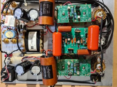

Offline triode
  • Posts: 77
Re: Shunt regulator board
« Reply #13 on: July 09, 2022, 11:23:54 PM »
All fixed!!!
Installed the board and worked fine ;D
Making music as good as ever, even better.
I think the Jupiter caps really good. Here's a picture of bottom side
Thank you PB and PJ
