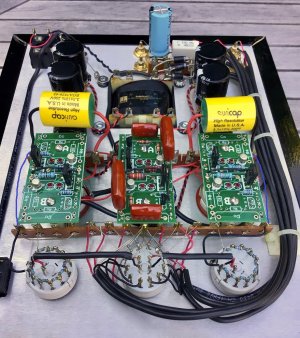

Do you have some clip leads handy?  If so post a picture of the bottom of your Foreplay and I can show you some places to connect them to try to isolate where the noise is entering.

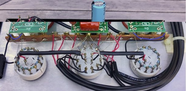

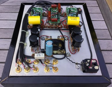

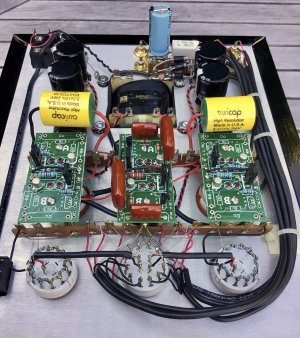

Reply #10 on: June 22, 2022, 11:27:04 AM
Hi Paul,
I have a multimeter. I'm not sure what picture to share, so I'm attaching a few.

    • Posts: 20302
Reply #11 on: June 22, 2022, 12:53:41 PM
Try putting clip leads as shown by the blue lines to see if this changes the nature of the noise coming out of the preamp.
The center board of your EFP3 needs two transistors swapped out at some point down the road, or you can add small heatsinks to the MJE350s to keep them a bit cooler.  Based on the condition of that center PC board, this preamp has been used very, very little.
