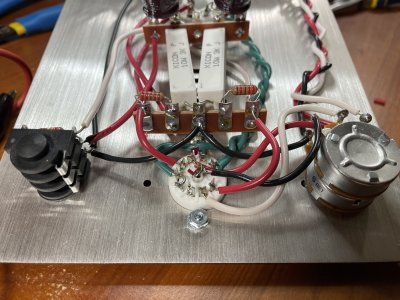

Hello friends.
Upon completion of the Crack kit I'm having problems with the readings at terminals 1, 2, 4, and 5. They are reading straight 0. Every single other reading, (and all the tests prior to this) have been good. The only other * reading according to the manual is at terminal 13, and that behaves as I would expect, wandering in some 10kOhm range or so.

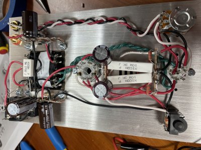

I tried resoldering some of the more suspicious looking joints before/around/after these terminals, but truthfully nothing looks any more out of place on the circuit surrounding those terminals than any other place. Apart from a few things on guitars, this is my first time soldering, so... brace yourself for the pictures I'm about to post. The first one is obviously of the area directly in question. The second one is an overall view but I'm not sure it will be any help in diagnosing really.
Hopefully this is a problem that is logical to figure out!

Reply #1 on: June 21, 2022, 06:54:53 PM
Terminals 2 and 3 wire to terminal 13, so I would double check that terminal 13 is OK.  Also be sure you're not seeing "OL" rather than a zero.

Reply #2 on: June 22, 2022, 02:20:42 AM
You're an absolute wizard. First off, it was saying OL, you're right. Second off, I went to inspect terminal 13 and visually I thought the solder looked fine but I didn't like how the wire was sitting so I was going to redo it anyway... when I went to apply a bit of pressure to the wire as I was just about to grab the soldering iron with the other hand the wire just pulled right out. Fixed that, and now all the values 1, 2, 4, and 5 behave expectedly.

    • Posts: 20204
Reply #3 on: June 22, 2022, 04:58:17 AM
I would also double check the solder joint where the black wires meet at the headphone jack.  It's super common to have a loose wire there as well.
