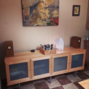

FWIW we use a Stereomour 2 with Blumenstein Orcas in our dining/kitchen at home. The FE83s in the Orcas are rated for around 87dB (seems optimistic but I have not measured them to say otherwise). The system plays plenty loud for our needs at modest level settings.

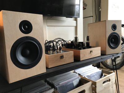

Im using the Criton 1TDX with the stereomour in a small apartment and the combination sounds amazing. Had to use some foam port plugs though to tame the bass due to one speaker being too close to a corner (these speakers really do go very low). Also just installed the shunt regulator and would 100% recommend it. No issues at all with lack of volume but in a much bigger room I could understand needing more power.
