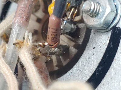

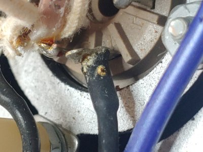

Pins 4 and 5 of the 6922 socket look good to me... but while checking I noticed that the left output resistor on pin 6 is fractured. I can also see some corrosion around and through the heat shrink jacket around the resistor on pin 1. I've attached some photos... please forgive my decision to use a non-standard tube socket as I wasn't aware the rotation of the pins was different from manufacturer to manufacturer.
I'm also noticing, thanks to these photos, how much uncleaned flux is on these solder pads. I should use my phone camera for this more often...
Edit: While some isopropyl and a toothbrush cleaned up the crap around the right channel/pin 1 resistor jacket, it caused the left channel resistor to break clean off. Going to begin the process of hunting through my stuff for a replacement and I hope I have that value. Edit2: I do not.
