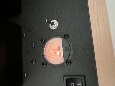

I'm at the Bias and Meter Test stage of the build.
Good news is both meters work and perform virtually identically.
When the switch is in the 50mA position the meter goes to the first mark to the left of the 40mA indication on the meter.
When the switch is in the 60mA position the meter goes to the first first mark before the 60mA indication on the meter.
Just not sure what could cause both meters to be off this way and not aligning with the build manual.  Open to ideas to check.

I can only get the meter to slightly increase.  Just under the second notch past 40mA.  When I flip the switch for 60mA the meter still comes under the 60mA reading.
Is this close enough or should the meter be hitting the 50mA and 60mA marks on the meter with ease?

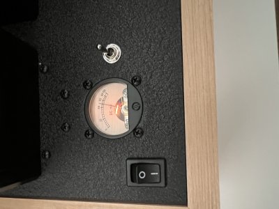

Instead of starting a new thread I thought I would keep this one going.
After the build was complete I went with the meters in 60mA switch position.  When the amps turn on the meters both start at the first notch below 60mA.  After some hours of playing the meter reading in both amps lower to virtually the identical reading.
Is this normal or a result of something I might have done during the build?

I did that during the initial build.  The adjustment on the meter only moves it up a few millimeters.
I listened for 1 hour this morning and the meters did not move downward much or at all.
I noticed this after 5 hours of continues use over the past two days.
