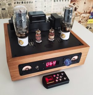

I have used the Khozmo motorized pot in a custom build, and it's really a very large attenuator that you need to design around. It isn't going to fit mounted in the metal plate on the BeePre because I don't believe the wood base is tall enough, and if you mount it into the wood base, then the BeePre becomes a lot harder to work on.  You'd also ideally want a 10K level control which sure is a lot less common than the 50K or 100K attenuators.
Every time I have customized a Bottlehead kit to add a remote, it has required rather substantial modifications.  The least crazy implementation was this Stereomour that I built some time ago.

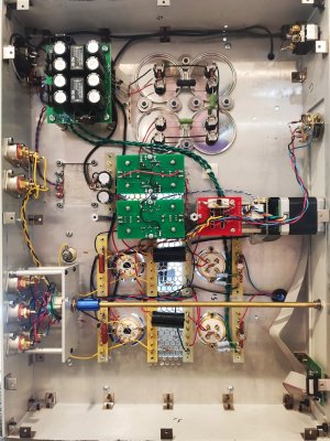

Hey Paul do you have an internal shot of your amp with the khozmo inside?
    • Posts: 20167
Reply #4 on: November 22, 2022, 10:17:38 AM
If you put a Khozmo into the BeePre, it will only work properly if you have the second upgrade installed.  The JV-8 remote kit is a bit unique, as you can take all the attenuator resistor values that create a 50K attenuator and buy new resistors that are 1/10th the value to get a 5K attenuator that will work with the stock circuit.  This is how I built the prototype that Jonsonad has.
I have attached a photo here of the Khozmo built into the BeePre it went in, but I'm not sure this photo will be much help ;)
