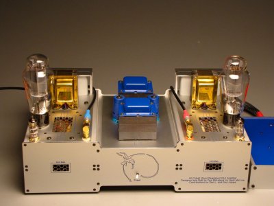

My Custom BH Stereo 2A3 amp has been running JJ 2A3-40 tubes for a year or more now and I find them exciting and trouble free. The sound is big, like the 300B's they emulate, and Eurotubes in Portland OR gives a good warranty in case of a bad one. I can recommend this tube highly.
