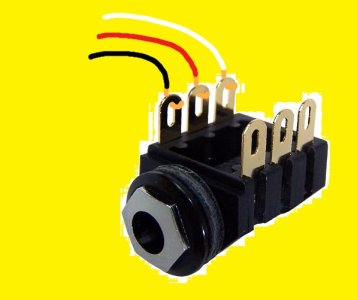

The thing is my 1/4" jack is switched (Rean NYS212). Will this work for a simple switcher? I tried looking up about switched jacks but am still confused. Am I able to just solder left, right, and ground to the left-side solder tabs? Or does something have to be done with the right-side solder tabs still for it to work? Forgive the crude Paint image and thanks for any help.

This is doable with the stock Crack HP jack and a pair of RCA jacks mounted into the wood base.
You'd need some new 2.49K resistors.  One would go to the HP jack terminal where the red wire lands ,then wrap the other end around the stripped bit of black wire connecting the sleeve terminals on the HP jack.  The other would go on the HP jack where the white wire lands, then wrap the other end around the stripped bit of black wire connecting the sleeve terminals on the HP jack.
This leaves two empty terminals that are connected together and down to the sleeve in the stock Crack 1.1 build.  Remove the connections to the outer tip and ring terminals so they no longer tie to the sleeve terminal, then you can use these as your preamp outputs.  They will automatically activate when you unplug your headphones.

But I'm still curious, is it possible to use a switched jack in the way I mentioned? Without soldering anything to the right-side solder tabs?

If you have a 1/4" cable plugged into the Crack, then you could feed that into a switch box. The other terminals on the jack short the output to ground when there's nothing plugged in (which is why you have to get rid of that to make a preamp out).

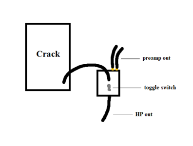

My plan was to--and I'm still considering it--to make a switch box that'll work like this (see attached photo).
I use the Bottlehead as a preamp going to my vintage Yamaha CR-1020 receiver, 70WPC. It is solid-state, but I've always turned on the Bottlehead first, to warm up the tubes, then the Yamaha. So, you're saying I should make sure to never turn on the amp first, then the Bottlehead? Or if the Yamaha is already on, couldn't I flip the switch to "HP out" on my switch box, then turn on the Bottlehead? Thanks for your speedy replies, Paul. You're a legend.

Reply #6 on: August 17, 2022, 02:46:25 PM
There are plenty of coupling caps in old amplifiers (and especially receivers!), I wouldn't worry about that.

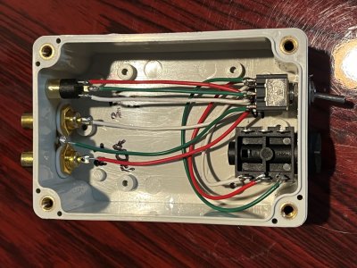

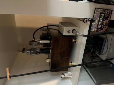

I slept on it and decided I don't really like unplugging and replugging my headphones whenever I want to use the Crack as a preamp, and I didn't want to drill into the Crack at all. So, I made the switch box with extra parts I had (1/8" Crack in, 3PDT switch, 1/4" HP out, RCAs preamp out). I think it turned out really well, and it's so convenient to just flip the switch. :)
« Last Edit: August 18, 2022, 09:03:06 AM by larcenasb »

The ground tabs on your RCA jacks are not in the right spot, and this could definitely cause some strange issues depending on what's connected to them.
Offline larcenasb
    • Posts: 163
Reply #13 on: August 19, 2022, 07:44:18 AM
Whoops! Yeah, they may not make good contact...with the plastic washer in the way. Thanks, will fix this today!
