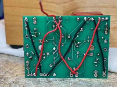

Front of board

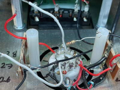

Reply #2 on: August 18, 2022, 09:47:25 PM

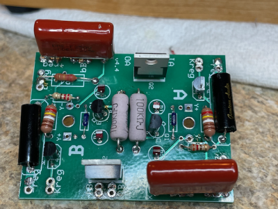

Back of board

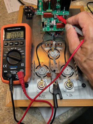

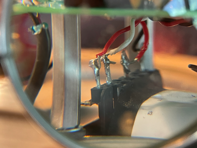

Reply #3 on: August 18, 2022, 09:49:32 PM

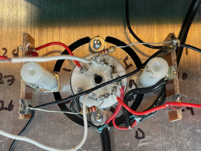

More views

Reply #4 on: August 19, 2022, 05:15:59 AM
With your meter clipped to the ground post like it is in the pictures, what DC voltage do you see at the +275V pad on the power supply board?  If that is also zero, then move your ground clip to the terminal on the power supply board next to the +275V one with the black wire leaving it and recheck.  The issue you're experiencing may have absolutely nothing to do with the second board you've installed.

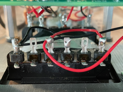

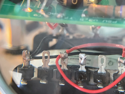

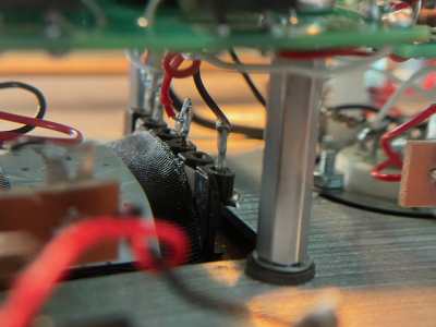

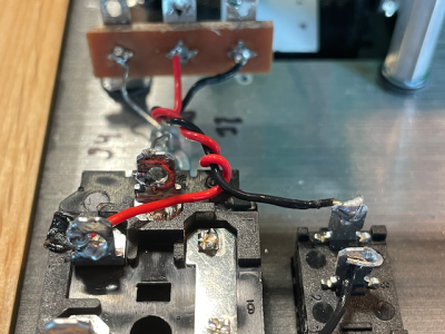

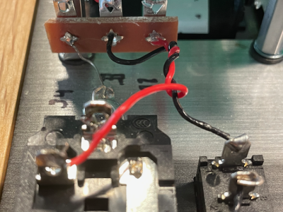

On the third check I discovered that I had reversed the wiring at 33L and 32L -- Black to 33L and Red to 32L. I'll put them in their correct places and recheck.
(First picture is the before, second is after)
Now when I check AC at 33U and 32U I get 0VAC !  Previous reading was 123.8 VAC.
One of the many odd parts here is that to have gotten to the shunt test, I had passed all the other tests. How could this have happened with the reversed wires ?
