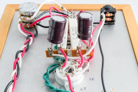

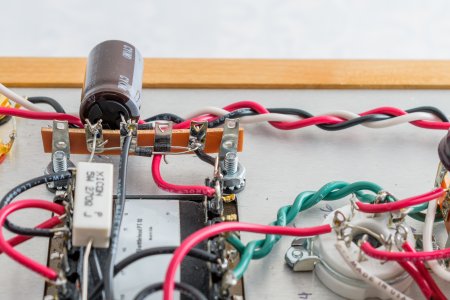

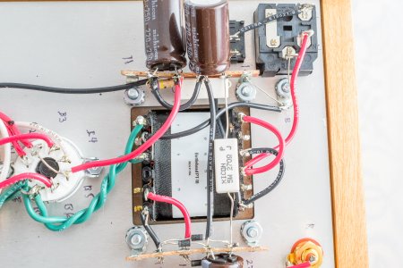

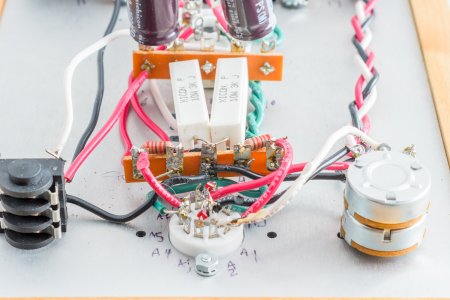

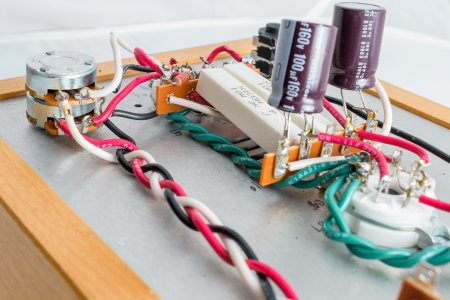

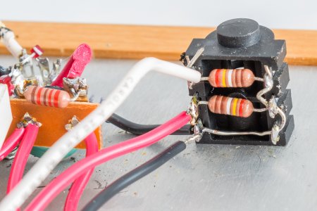

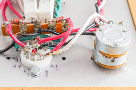

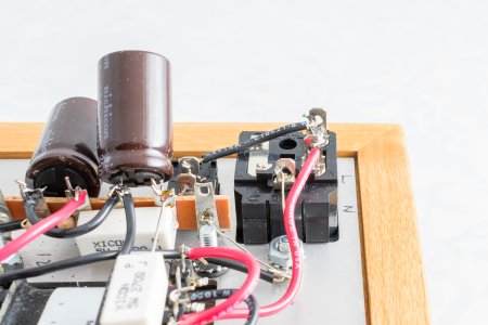

Can you post some build photos?  You most likely have a loose joint or something touching that shouldn't, and that's causing these issues.
Offline hryc111
    • Posts: 13
Reply #2 on: August 21, 2022, 08:02:49 AM
PB:  Attached are a few photos.  Thank you for taking a look.

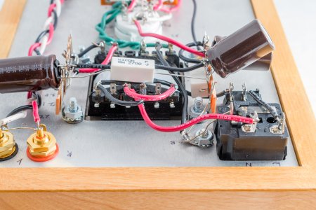

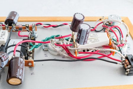

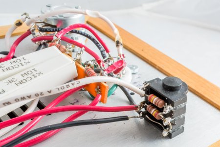

Reply #3 on: August 21, 2022, 08:07:42 AM
PB:
A few more photos in case they are useful.  Thank you again.

Can you carefully measure the voltage at A3?
I would definitely trim back a lot of the leads that are poking out, and if you're soldering iron has adjust able temperature, it's not turned up enough.
